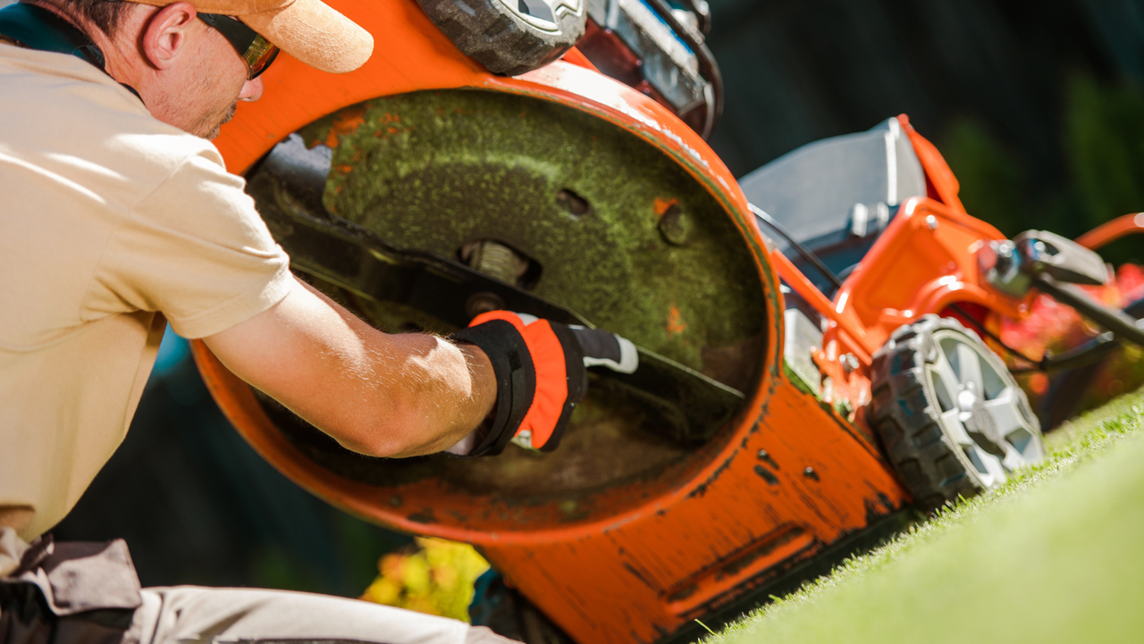

How to Remove Push Lawn Mower Blades
  1. Tilt the mower safely Always tilt it with the carburetor and air filter facing up.
  2. Wedge a block of wood Place it between the blade and deck to prevent spinning.
  3. Use a wrench Loosen the blade bolt by turning it counterclockwise.
  4. Remove the blade Take note of its position for proper reinstallation.
  5. Inspect the blade Look for dullness, bends, or cracks.

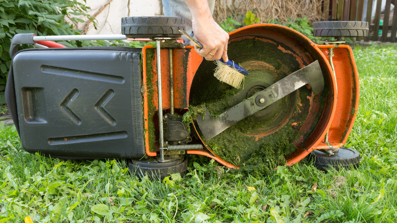

Cleaning the Lawn Mower Blades Before Inspection
Once removed, clean the blade:
Cleaning the Blade Before Inspection
  • Use a wire brush to remove grass, sap, and debris.
  • Rinse and dry thoroughly.
  • Apply a thin coat of oil to prevent rust.

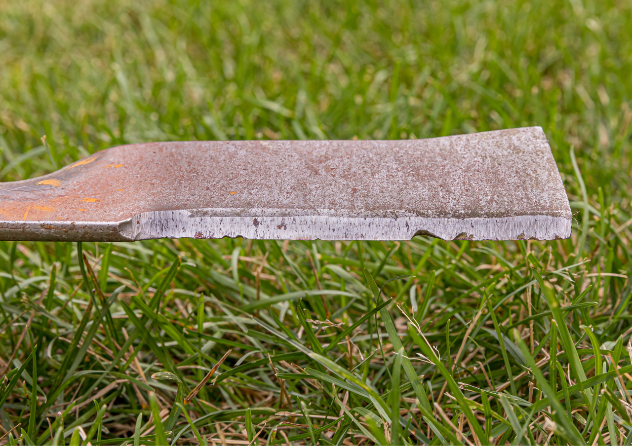

Now, inspect for:
  • Cracks
  • Bent edges
  • Nicks or chips
Replace vs. Sharpen Lawn Mower Blades
Condition Action
Minor dullness Sharpen with a file or grinder
Visible cracks or deep nicks Replace immediately
Uneven wear Replace
Bent blade Replace (don’t try to straighten!)
